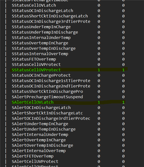

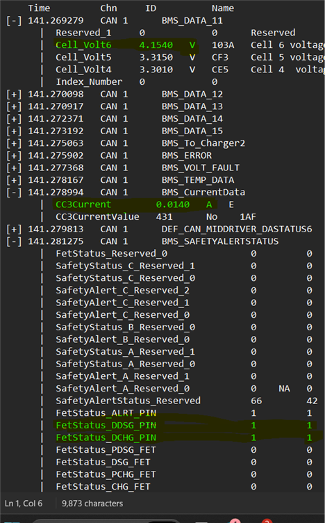

I am facing an issue with BQ76952 device regarding OVP protection. When we try to test the OVP protection, We raise the voltage for a cell above 4.0V, which is the threshold for OVP. We are also ensuring that the current is positive, which means the device is in charging mode. When the cell 6 voltage crosses the threshold, we get OVP status flag, OVP protection flag and OVP protection latch flag set. But the Charge MOSFET remains ON. It does not switch of although the protection is enabled. after about 5 seconds, we get PF depending on the situation, sometimes OVP Permanant failure flag or sometime Charge FET protection Permanant failure. But we are not getting the charge MOSFET turn off when OVP error has happened.
following is a screen grab for failure. In this screenshot, we can see that the MOSFETS are turned Off but they are turned off due to PF, after 5 seconds. Not when the OVP protection fault was raised, or latch was raised.
In First Screen I have highlighted the Cell 6V. (The issue is not with cell 6, but with all the cells. we just happen to check with cell 6 while getting the screen shot)
We have highlighted CC3 current, And the FET status.
In the below screenshot we can see the Cell overvoltage protection and cell overvoltage latch flag set.
In below screenshot, we can see the Charge FET protection permanent failure has been set.

    Can you share a .gg file from bqStudio as well as a screenshot of what you see from that? Also, do you know if the CHG FET is turning OFF and then back ON after OVP is triggered but before Permanent Fail is triggered? A waveform from an oscilloscope can help verify that.
    Alexis
  • Hi Alexis,
    unfortunately, I am not working with BqStudio. I am testing the PCB using CAN messages only.
    We have checked if the Charge MOSFET turns off, we have found that the Charge MOSFET only turns off after permanent fail. I hope you meant the Charge FET gate waveform. I will arrange it.

    We had some issues with the test setup. We were trying to test the fault in Charge mode, which was not set up correctly. The current direction was in discharge more only, which allowed current through the body diode and would switch off only when the Discharge MOSFET is turned off because of the PF protection.
    Sorry for the delay in replying. I will let you know when we are ready with the setup, and we are able to test.
