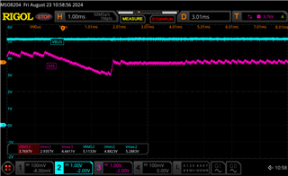

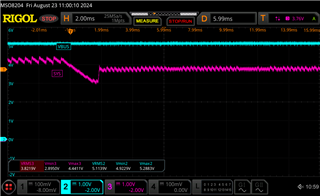

We are currently using the charger IC BQ25628ERYKR in conjunction with the fuel gauge BQ27Z746YAHR for charging and monitoring a 3.7V, 1500mAh LiPo battery in our new design. However, we are encountering a couple of issues:
  1. Charging Issue:
    • We are unable to charge the battery through the fuel gauge. We’ve observed an unstable output at the SYS pin of the charger IC. Despite providing a stable 5V input, the output voltage at SYS as well as the BAT voltage of the charger IC fluctuates between 2.7V and 4.2V.
    • Could you please help us understand why this instability is occurring and how we might resolve it?

For your reference, I am attaching images showing the varying voltages along with the charger IC input.
