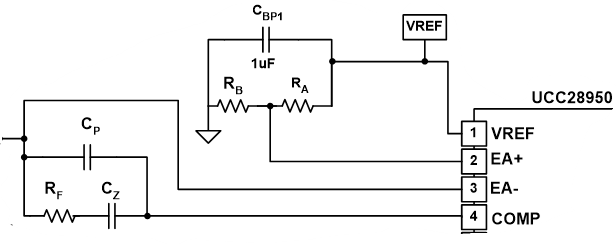

Provided below my error amplifier connection.
Used values are Cz= 10nF, Cp = 1500pF and Rf = 15K.
My design is for 3000W 48V battery charger. output is configured for 56V DC.
I am providing my feedback signal at the junction where Rf and Cp tied together. EA+ is provided with 2.46V.
