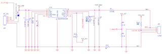

Hello TI Support,
We have been using the BQ24095DGQR charging IC in our various applications from last 2 years. In all applications, this ic working fine. In charging condition its temperature is 30'C to 35'C.
But Now in new design this IC temperature rise 85'C to 95'C during charging. So we are not sure what is the issue. So could you please help to solve this issue.
Please find below design. Let me know, if require any others details. Please look it here and reply asap.
