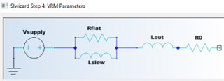

So sorry for the delay. Can you please describe the parameters you need in more detail? I think the Lout and R0 seem relatively straightforward (I'm thinking a first-order-approximated supply output impedance), but I'm not sure about the Lslew and Rflat parameters. Which software package are you using for your signal integrity analysis?

We are using Ansys SIwave for signal integrity analysis. Ro and Lout are output resistance and inductance respectively.
Lselw and Rflat are used to model the transient behavior of the VRM.
Typical equivalent circuit snap from the tool is attached here for your reference.

The parameters are the following:
Rout | 21.3mΩ |
Lout | 16.3nH |
Rflat | 23mΩ |
Lslew | 260nH |
