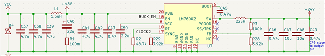

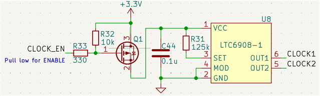

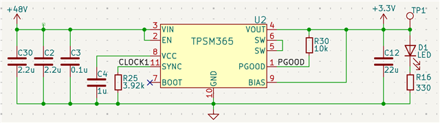

  • Hi Ben,
    Following your advice I have ended up with the following circuit
    At start-up, the TPSM365R6 is in auto-mode at 1 MHz due to the pull-down resistor.
    Once the 3.3V output is stable and PGOOD is high, a microcontroller can enable the external clock (CLOCK_EN) through a P-channel MOSFET. The LTC6908-1 clock IC has two outputs (180° phase shifted outputs to reduce peak current) set at 800 kHz with spread spectrum functionality. When the clock is enabled the TPSM should now switch to SYNC mode.
    The LM76002 can be enabled from the microcontroller (BUCK_EN) with CLOCK2 providing the clock signal.
    It would be great if you could review this. Both VINs of the bucks are filtered by the same LC filter shown in the LM76002 circuit.
    I especially have my doubts about the pull-down resistors value on the sync pins. The LTC6908-1 datasheet mentions "Oscillator Outputs. These pins can drive 5kΩ and/or 10pF loads. Larger loads may cause inaccuracies due to supply bounce at high frequencies". I assume the pull-down resistors need to be below 5kΩ, so I set them equal to the 3.92k feedback resistor to reduce the BOM. But I cannot find any current drive characteristics in the datasheet, nor any information on this on the buck datasheets. I can always experiment and change them with a prototype, but a calculation to get the value approximately correct would be helpful. The parasitic capacitance should be minimal since the traces will be kept as short as possible. Thank you Ben!
  • Hi Daan,
    The pull-down resistors need to be greater than 5Kohms, not the other way around. The output of the LTC6908-1 can drive no lower than 5kohms or no higher than10pF loads. Remember, it is the drive strength of the LTC6908-1 and the resistor or capacitor is the load that is seen by the LTC device.
    The input of the SYNC pin for the 76002 and TPSM365 are usually high impedance so adding a known impedance to GND should be high enough to not load down the output of LTC6908-1.
    Regarding your schematic, the output voltage for the 76002 will be higher than 24V (26.67V). Was that your intent? Other than that, the schematics look good to me.
    Ben
