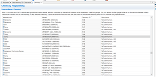

  • I'm using CHEM ID 0x2145 which corresponds to the sony us18650vc7 and the physical battery I am using is a Molicell P30B (so the programmed chemistry seems to match the real thing)

    How do you know the ChemID is an ok match if you are using different cells?
    If you have not used the GPCCHEM tool I recommend you use that to get a chemID match.
    A successful learning cycle cannot be completed without a valid chemid match.
    Diego

    Here is the data I used for the the GPCCHEM tool and the results I got.
    The results told me to use a chemistry that corresponds to the Sony US18650UC7, which has the same 18650 package, the same nominal voltage of 3.6V, possesses a similar nominal capacity (3500mAh vs 3000mAh) to the Molicell P30B I am using. They're also both Lithium Ion batteries that seem to be using Ni-Co-Mn chemistry. So, I think it's highly probable that this is either the right chemistry, or at least pretty close to it.
    Thanks for confirming that you have the correct ChemID.
    It has been seen that the update status will get stuck. If you have gotten a Qmax update then you have reached update status 0x05, you can continue with the learning cycle process and see if you ra tables update, if your ra tables update you have reached learn status 0x06 and have completed a learning cycle.

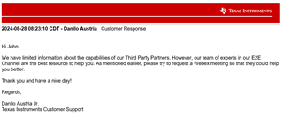

    Would it be possible to get a webex meeting with you? Or with someone? Is this the correct place to ask?
    I've asked for assistance and been told there is no FAE assigned to my location.
    I do not think a meeting is necessary at this point.
    Please continue to work with Danilo on cordinating a meeting.
    If you have further questions regarding the learning cycle you can ask here.

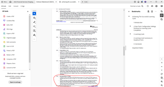

    I was following what was done in this post ( https://e2e.ti.com/support/power-management-group/power-management/f/power-management-forum/1320753/bq34z100-r2-learning-status-bit-not-updating-to-5-after-following-learning-cycle-steps-for-an-lfp-pack ) wherein the learn status updated after the second discharge cycle instead of the first charge cycle, because after resting after my first charge cycle my learn status did not increment to 5 either:
    6. I still went ahead and discharged it @ C/5 (1.34 A). As it was charging, VOK turned ON again. DSG turned ON. SLEEP turned OFF. REST turned OFF.
    7. After discharging was complete (down to 22V), I waited for a few hours, SLEEP turned ON, VOK turned OFF, DSG turned OFF, BATLOW turned ON, CF turned OFF and REST turned ON. Luckily this time though, and finally, Learned Status turned 5!!
    From the log file sent it appears that you only discharge to empty and let the battery rest. You also said VOK and Rup-Dis were cleared at this point. Update status will not flip from 4 to 5 at this point. You need to charge to full, relax, then discharge to empty. The steps are in the document provided below.
    Achieving The Successful Learning Cycle (tij.co.jp)
    Diego
