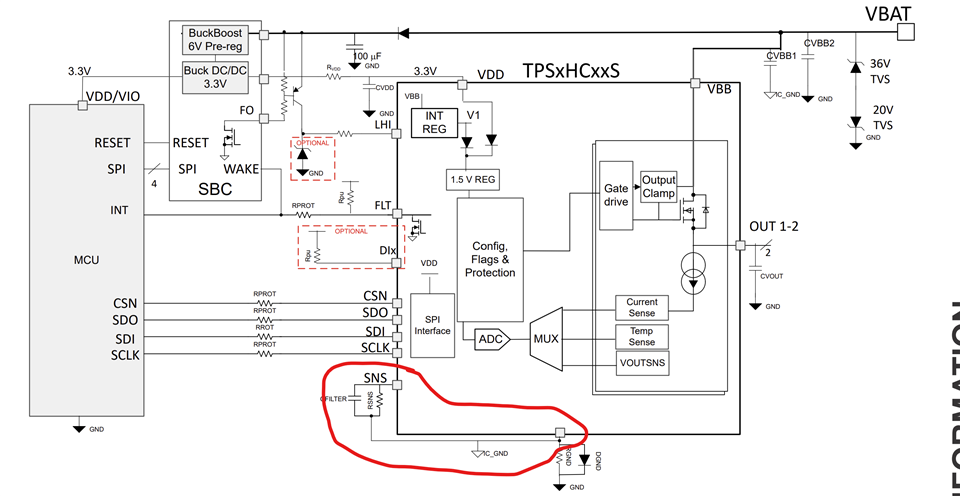

  • Luke,
    So you shouldn't have to enable the open load detection for the ADC sensing to work, but one step I see that is missing is clearing the ADC_CONFIG.ADC_ISNS_DIS bit to 0. This will specifically enable the global conversions of the load currents.
    Tim
  • I tried changing the ADC_CONFIG.ADC_ISNS_DIS bit to 0 as per the answer, but the problem is not resolved and remains the same.
    Are there any other registers that need to be set?
  • Hello Haejin,
    So the steps you would need to do are:
    • Set the DEVICE_SAF.ADC_EN bit
    • Clear the ADC_CONFIG.ADC_ISNS_DIS bit
    Once you do this, the ADC result will be periodically updated in the TPS2HC10S_ADC_RESULT_CH1_I_REG register.
    I think I see the problem though from your schematic. Your SNS pin is going to system ground, when it should be going to IC ground:
    What is likely happening here is that the internal ADC is trying to use the SNS pin resistor with respect to IC ground, however since the SNS resistor is connected to system ground it is producing erroneous results given the mismatched ground potential.
    Tim
