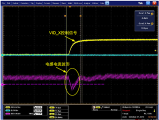

Customer wants to know the negative current limit capability for TPS564201, we didn't find this spec from datasheet, can you help to share with us? Thanks a lot!

This is not the case for Eco-mode. Based on our experience in past, customer used the DVS function to control FB pull down voltage, so under some cases, even in FCCM mode, the DC/DC will behavior with negative current, please refer to below TPS56628 real test waveform for example. So please help to double confirm with design team to confirm the penitential negative current handling capability for TPS564201 device.

The device is 4A rating, so considering MOSFET loss, negative current less than 4A is OK. But TPS564201 is Eco mode device, so it will turn off low side MOSFET when inductor current crosses zero.
