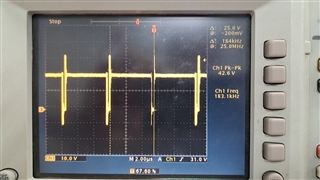

         We have more questions for the TPS61289,the circuit and waveform are as shown in the attched.
        1: According to this circuit , MosFET and TPS61289 are burned out after we power on.
        2: After we disconnect U2 (LB2 R11 R12 R13 R14), The U1 can work normally.
        3: We measured the SW waveform and the overshort is over specification, How do we solve this problem?
            SCHEMATIC1 _ OLED_BOOST_BD_TPS61289.pdf
  • Hi Chen Chin,
    The schematic looks ok.
    It seems that the device encounters an over voltage.
    The positive and negative spike both look high.
    Could you give me the layout to have a review?
    Also, could you provide more details about the parallel working?
    Fergus
  • Hi Fergus:
                    1: layout as attached.
                    2: Vin 20V Vout 21.5V  Iout 4A
                    3: I retest the short ground for measurment, The positive is 31V (Spec is 34V) and negative is -3V (7nS).
                        Does this measurement result meet the specification?
    017138721513.zip
  • Hi Chen chin,
    The switching and the device are too far away, and the output capacitors are far.
    This causes the large Parasitic inductance and causes high spike.
    For the spike, it is now acceptable, but the situation can be much worse when heavy load.
    Additionally, the spike of upper MOS (inside the device) can be high and causes damage.
    Fergus

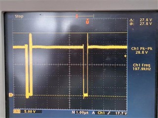

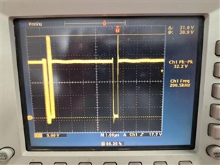

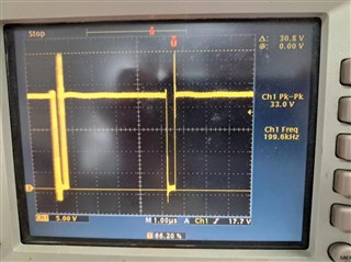

  • Hi Fergus:
                     I close the switching and the device but the spike is same. Please see the attach a picture.
                     Than i close the output capacitors and it seems to have some effects. please attach a picture.
                      Does this measurement result meet the specification?  or other suggestion for us?

  • Hi Chen chin,
    You are right about the output capacitors.
    It absorbs the spike and influence the spike a lot.
    It worth trying to work with paralleled devices.
