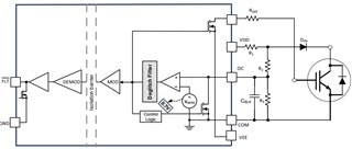

In UCC21710, can I use the current source available in pin AIN for the design of De-SAT protection in a conventional way?

    I don't want AIN pin to monitor Vds/Vce. The monitoring and protective action will be done by OC pin only. Rather than making use of Vdd to monitor Vce/Vds, I thought if it is possible to use the current source available at AIN pin. This will be possible if I connect OC pin to AIN pin and use conventional DESAT protection circuit. Will it be okay to do so?

  • Hi Vivian,
    In UCC21710, there is no DESAT pin, instead we use OC pin. OC pin doesn't have an internal current source. OC pin serve the purpose of DESAT protection by creating a current source from Vdd. Please see the figure below for your reference.
    Now, my doubt is, whether it is recommended to use the current source of AIN to drive the DESAT protection through OC pin. This could help me to avoid the resistor network that serves the purpose of making a virtual current source.
  • Hi Sandeep,
    Understand, sorry for mistaking the question.
    I think that is possible - I just ran a quick simulation. You should have a resistor divider network (R1/R2) to make sure OC pin voltage does not exceed 0.7V during normal operation, and make sure AIN pin never exceed 5V. So, if your Vds/Vce drop is too high, it's possible that this approach would not work.
    We've never actually tested this and never seen other customers do this, so I can't speak on the recommendation part.
    Hope this helps,
    Vivian
