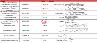

The flyback converter design we are supposed to proceed with has 4 secondary windings say, 15V-1A, 12V-2.5A, 5V-0.5A and 5V-0.5A. I have a doubt on the primary current requirement in this case. Since we plan to regulated 15V-1A only, the primary current as per the calculation sheet is coming around 1.5A. The design is done for 50W, 80% efficiency. The calculation FYI is attached here.
