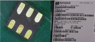

we purchased the part#TPS3703B3080DSERQ1 from Mouser,but the pins of TPS3703B3080DSERQ1 are yellow,
the customer suspects that the parts may oxidize. the customer want to return the parts to Mouser.pls help to check.
Hello! Will you please info how many units you purchased from Mouser. This is an MSL 1 device with NiPdAuAg lead finish. Besides the discoloration on the leads, did you have any solderability issue?
