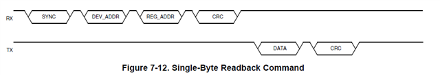

    If you readback the status of FLAG0, you should follow below frame, I am not sure why do you get these values. please check this read process.
    The purpose of asking schematic is to check the HW connection of this device and to see how you do the test. Thanks!
    The Read frame is implemented as your picture from data sheet, valid data is read on FLAG0 register.

  • Hi Stefan,
    If you read from the FLAG0, it's supposed to be FALG0 data + CRC data. For example, if the FLAG0 shows 0x03, means the power-on-reset flag and error output flag is set to 1. You need to clear them first, if you first power the device, the device automatically switches to INIT state from POR state with FLAG_POR and FLAG_ERR set to 1. more details please see 7.4 Device Functional Modes of the datasheet. Thanks!
