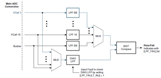

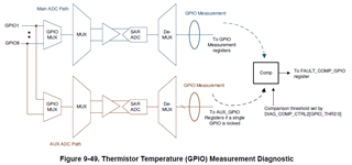

i saw the following picture in our datasheet.
my question is whether BIST compare threshold can be configurated like DIAG_COMP_CTRL2[GPIO_THR2:0]?

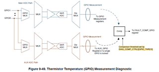

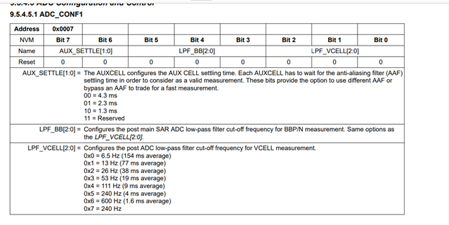

Hi Jay,
The device is able to change the LPF filter frequency if that's what you mean, as seen in the image below. However, the actual LPF and diagnostic LPF comparison does not have a configurable threshold.
John
hi John
ok got it
