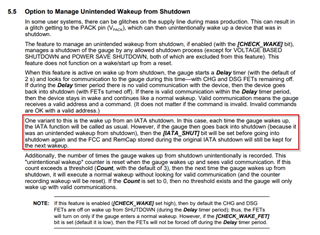

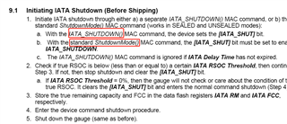

Hi Anthony,
two question regarding the IATA shut down mode.
1. the differences between IATA shut down mode and normal standard shut down mode.
2.how charging wake up battery from IATA shut down mode? only with external power supply? need I2C communitcation or not?
I believe the difference between the two are the thresholds since the standard shutdown mode is expected to occur at a much lower voltage. Also, the IATA Shutdown has more conditions when woken up since the packs may be checked in transport:
I believe a charge current being passed across the SRP/SRN pins for enough time would allow for wake up.
