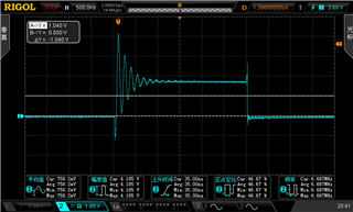

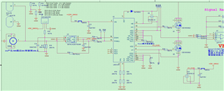

过冲和振铃问题
The ringing on the switch node can be reduced by increasing the gate resistance to slow down the switching edge dV/dt. A snubber circuit can also be added to the switch node to dampen ringing.
Also make sure to minimize parasitic inductance in the layout.
