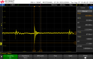

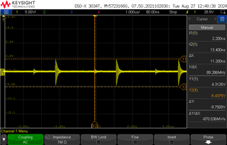

Hello Technical Support,
  • For designed and manufactured  DC To DC up converter 10.5v to 28v:
Tested 90 MHz/ 2v ripple at output and Gate FET transistor.
  • Is there a way to debug or fix such significant ripple ?
  • Is there a way to improve ripple ?
  • Attached schematic, BOM and layout.
