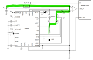

  • Hi Stefan,
    I have one last question about the current way in the design.
    Does it goes through the H bridge ?  This is to make the component selection as 15A will cross the TEC driver.
    Thank you,
  • Hi Thibaud,
    the LM5176 circuit works as SMPS and provide with using the inductor a defined output voltage.
    It is not sinking current as you have drawn above but uses the 4 MOSFET depending on the required operation mode as BUCK, BuckBoost or Boost.
     Stefan
