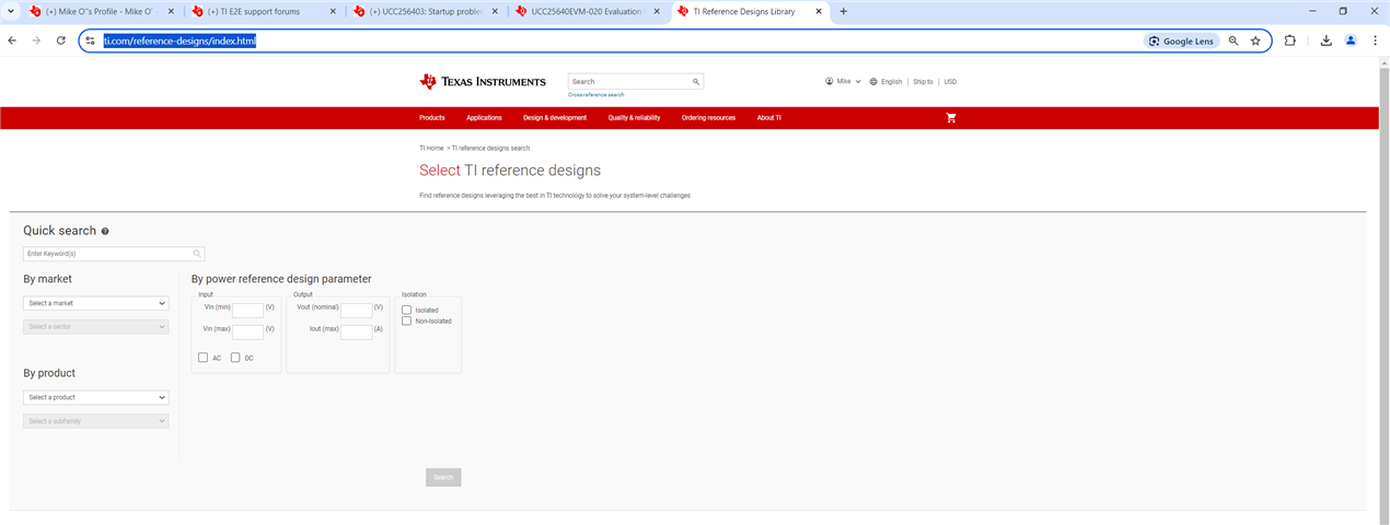

    TI has a reference design library that you might find useful as well.  There may be a design that already meets your requirements that TI has already done, that you don't have to trouble shoot.  The designs have a proven layout and BOM.  The following link will bring you to it.  You just need to input and output power requirements and tool will find design that meet or are close to meeting your design requirements.
    https://www.ti.com/reference-designs/index.html
