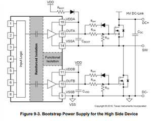

    Yes, This Its seem to be an ideal choice, though we have one doubt,
    Our secondary side voltage is approx 12VDC, for FET driver, will this IC work fine with it?
    As I Was going through datasheets, It looks like it require voltage more than 14.7V as per below table!
    JFY, We will use bootstrape power supply mode.
    Can you please help us to understand it better?  Do we have to increase our VDDA and VDDB above 14.7?

  • No problem Umang,
    12V on the secondary side voltage supply will work with the 8V UVLO version (UCC21530B).
    Hope this answers your question. Let me know if you have anymore questions!
