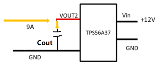

This load requires 10V and 1V as the input and output terminals, and I want to generate these two voltages by stepping down 12V using two TPS56A37. The 12V is supplied by a shared input power source.
From my understanding, current flow from 10V to 1V. It means the current will flow into the TPS56A37 that generates 1V. Is there any problem with this configuration?
Hi Gui, thank you for your reply.
The load is a panel approximately 30 inches in size. I saw in the datasheet that TPS56A37 can generate 1.05V and I did indeed obtain this voltage on my PCBA.
But when I connected the load to 10V/1V, there was no response. And the 1V was pulled to around 8-9V. Do you have any suggestions for practical use?
Hi Hedy

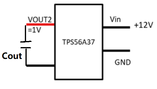

The buck converter generates a constant vout 1V as below:
When connect the 9A current source, the 9A will charge the Cout of TPS56A37 and the VOUT2 becomes higher than the set value(1V) . The TPS56A37 will not switch. The VOUT2 will charge up to a value close to VOUT1.
Sorry that I haven't seen similar application like this.
