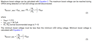

We are now designing the schematic of LP8864, and we have a problem about the setting of Vboost.
Why should be set the max and min for VBoost?
If we set the R1=680K, and R2=42.2K, the VBoost_Max=47V, will the initial output voltage be kept at 47V?
When will the min for VBoost happen? Also, If R1/R2=16, being larger than 15, will there be any risk?
Dave
  • Hi, Dave
    Our device contained the adaptive voltage control, so it required a voltage range.
    Initial voltage should be 88% of the voltage range, Vmin+0.88*(Vmax-Vmin)
    A higher ratio of R1/R2 may see some loop challenge.
    For min voltage, if may happened in some fault condition.
