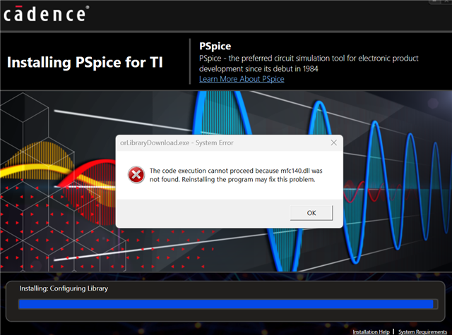

PSPICE-FOR-TI: I am trying to install the PSpice for TI , I also have 30-Days installation key, But I am facing error like requirement of .dll file . Plaese help me to get the .dll file .
Part Number: PSPICE-FOR-TI
Dear TI,
  • Hi Haresh,
    THis is probably due to C++ not being installed.
    A similar error had the following solution:
    Typically this occurs when Microsoft Visual C++ is not installed on the machine. Please try the following steps:
    1. Open a file explorer and navigate to C:\Cadence\PSpiceTI\tools\msbase\vn2015
    2. In this directory, double click vc_redist.x64.exe (The vc_redist.x86 is for 32-bit machines)
    3. You should see a pop-up from Microsoft Visual C++. Please check the "I agree" box and then click Install.
    4. Select Yes or Allow for any prompts from the installer. When it is finished, it will display a message showing "Setup Successful."
    5. Please try running PSpice for TI
