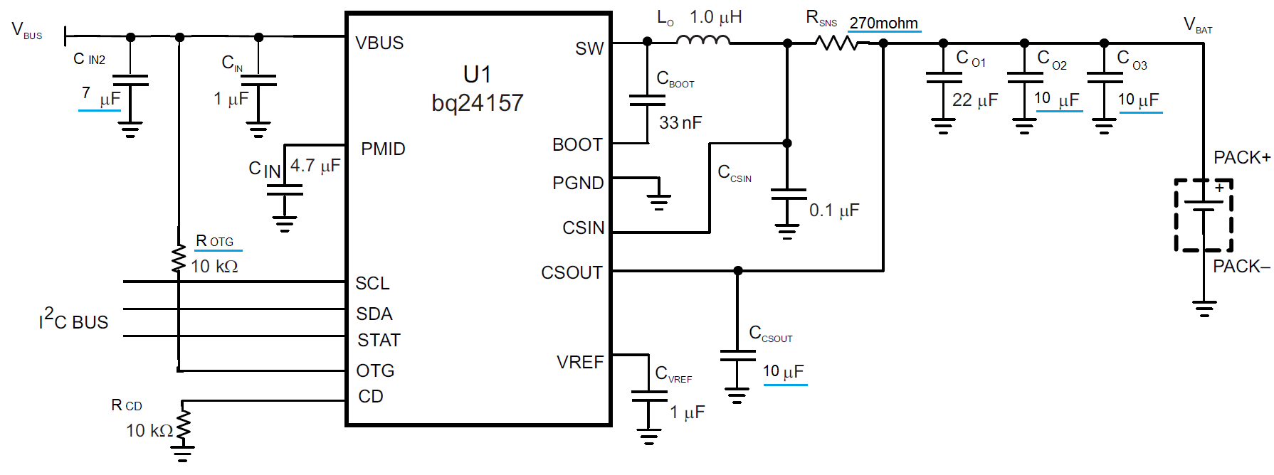

    Thank you for your reply. The register settings and circuit diagram are shown below. The blue lines indicate the parts that are different from the reference circuit.
    Register setting
    Circuit diagram

  • Hi, Juan Ospina
    Vbus has an normally-on MOSFET switch and a voltage sense resistor connected to it.

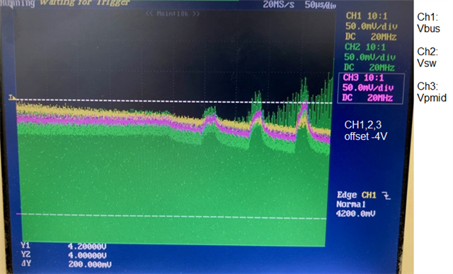

  • Hi Carrot,
    The register does seem to confirm this is DPM related. Can you share the VIN waveforms after USB removal that might capture the 4.2V stability? If possible please include this waveform alongside VCSIN, VPMID, and SW waveforms as well. Is it possible there is current leakage through the MOSFET?
    As mentioned before, with the capacitances you shared it should not take much to discharge the VIN capacitors so I expect there might be some leakage current going into VIN that is about equal to the 14uA VIN quiescent current, otherwise the capacitors would discharge fairly quickly. Does applying a light load (very high resistance) cause VIN to fall below the 4.2V?

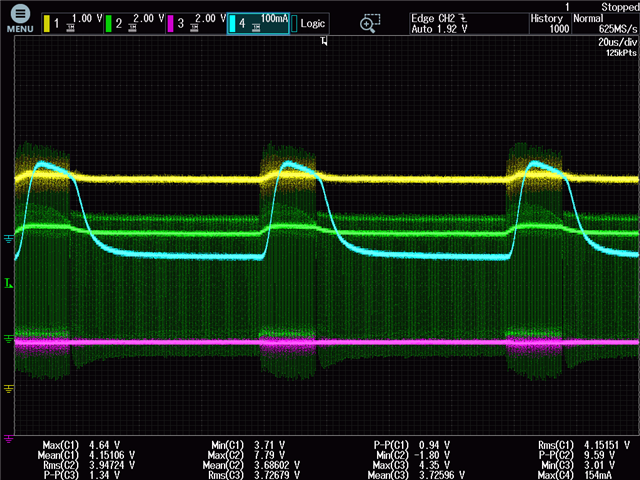

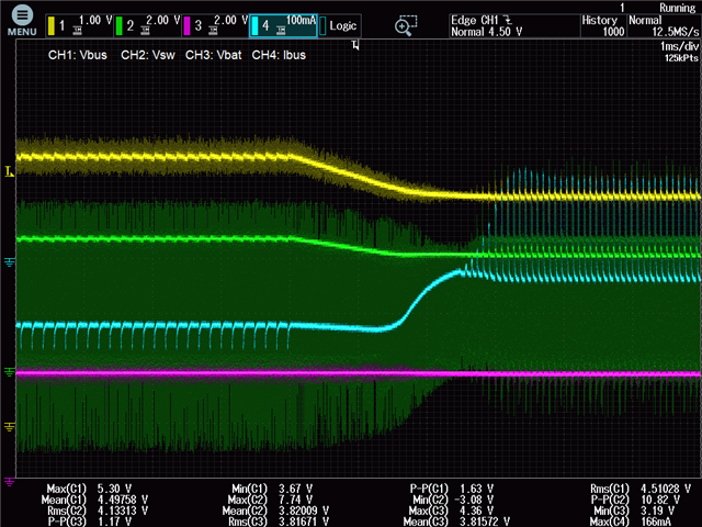

  • Hi, Juan Ospina
    I shared the waveform of Vin (Vbus).
    It seems that there is repeated backflow to the AC adapter and charging to the battery.
    When a 1kΩ load was connected, Vin fell below 4.2V.
    Are there any specifications for hysteresis, response, or delay in V_IN_PDM?
    Carrot
    wave1: Vin (Vbus) and VSCIN (Vbat)
    wave2: Enlarged right side of wave1
    wave3: Vpmid and Vsw near the start of 4.2V
  • Hi Carrot,
    This does appear to be boost back behavior. This can sometimes take place on this device, particularly in circumstances where you are disconnecting a long adapter cable or due to a leaky BOOT capacitor. Can you try increasing the BOOT capacitor slightly to see if the behavior is improved.
    Juan Ospina
  • Hi, Juan Ospina
    Increasing the BOOT capacitor to 470nF did not improve. The cable is 1m long. But the inside of the AC adapter is a black box. I will look for another solution.
    Thank you.
    Carrot
