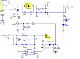

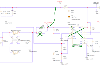

Dear Team,
We are utilizing the TPS23755 Power over Ethernet (PoE) Powered Device (PD) controller in conjunction with the TPS2121 for seamless power switchover between PoE and DC jack. However, we are encountering an issue where the switchover is not as seamless as expected. Specifically, we are observing a small delay during the switchover process, which is causing our system to reboot.
Are there any specific recommendations for optimizing the switchover time between PoE and DC jack?
Could there be any additional factors or components we should consider to minimize the delay?
