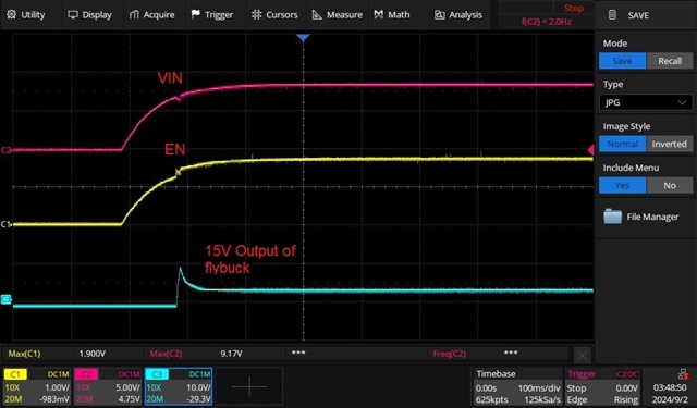

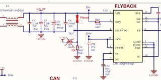

Dear TI Support Team,
We are using  LM5160QPWPRQ1 part. Refer SCH here:
https://community.nxp.com/t5/S32K-Knowledge-Base/Automotive-Electrical-E-compressor-Aircon-RDB-based-on-S32K142/ta-p/1414316
But turn-on behaviour is very erratic. Divider on EN/UNLO is 51k & 10k.
Sometimes it turns on at 8V, sometimes to 9V..14V.....and so on. We are not able to conclude. We need min turn ON voltage 8V.
We think it has some relation with rise time (slew rate) of Enable signal.
Pls support.
Thanks.
