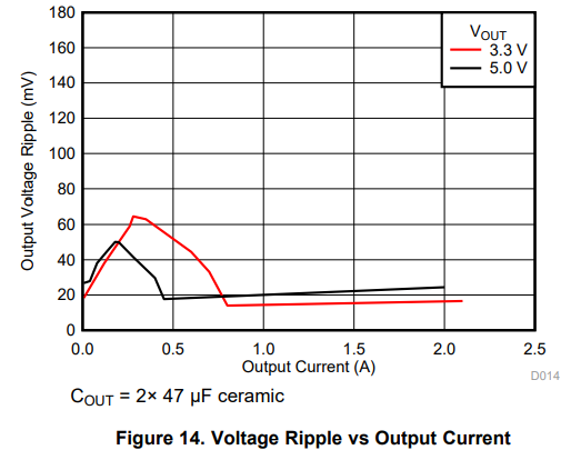

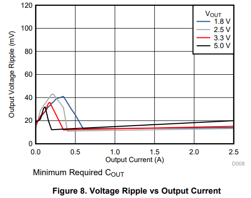

I am using TPSM84209 for a 0.4 A application. Input voltage is 15 V and output voltage is 5 V.
1- I have a 100 uF electrolyte and a ceramic 100 nF near the pins of the IC. Do I need to increase the size of the ceramic capacitor? I thought with having only 0.4 A, the ripple in the input cap is small and does not need to be size higher.
2- Will pulse skipping happen with these specs? In the graph in the datasheet, it looks like pulse skipping will happen for any current with these voltages.
3- Does pulse skipping result in output voltage overshoot?
4- What size of copper plane do I need given that we have ~0.3 W of power dissipation? In the datasheet, 63mm*50mm is mentioned.

    Please reserve the 100nF ceramic cap, you can add one 2.2uF ceramic Cin.
    Pulse skipping will not result in output voltage overshoot. The Vo_ripple can be larger than the ripple under CCM mode.
    I didn't find the fsw vs load curve in the datasheet, but seen from the Figure 8 and Figure 14, it's related with the Cout selection.
    the 63mm*50mm is based on the EVM. With this copper size and the 4-layer PCB, The RθJA parameter is 32.7℃/W. In our application the load is only 0.4A and the power dissipation is small. Should not have concern about the thermal performance.
