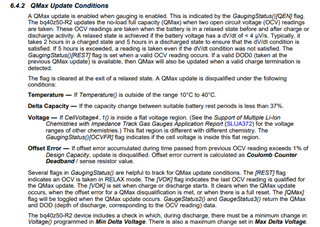

    Looking into the log file, I have concerns that the Flat Region condition of the Qmax update is being broken, hence why an update is not occurring. If possible, can you please send the .srec of the gauge so we can confirm whether this is the issue?

    As another possibility, the Technical Reference mentions an "offset error" condition that prevents Qmax updates (SLUUBK0B, Section 6.4.2). However, we didn't understand how to check the offset error. The reference says it "accumulates during time passed" suggesting it's a time-varying value, but then the reference gives the equation CoulombCounterDeadband/SenseResistor, which would seem to a ratio of constants? We were confused. Nonetheless, we did turn on the data memory autoexport for this run--at 5 min intervals--so have a whole gaggle of .gg.csv files. If the offset error can be calculated from those files, and you let us know how to make that calculation, we can independently check the offset error on our side.

    After looking into the .srec, I believe that the reason that the Qmax is not updating in the second cycle is due to the voltage of Cell 3, which is less than the other cells. In the relax after charge where OCV measurements would be taken for Qmax updates, the voltage of this cell is within the flat region which is most likely invalidating the update, along with not allowing your Update Status to change. I believe if cell 3 was at the same voltage as the other cells this issue could be avoided.

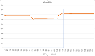

  • Hi Charles,
    1. Hmm, why didn't GaugingStatus()[OCVFR] bit fire during this time? Does it require multiple cells to be in the flat region to fire?
    I believe the OCVFR bit does fire at this time. In the image above, the OCVFR can be observed being set once the voltage enters this region.
    2. How do I find the flat region for my cells? Is it somewhere in the srec file, or is it maybe stored somewhere in the .gg.csv file? If I know the voltage limits of the flat region, then I can redesign the experiment to keep Cell 3's voltage depressed (to test the cell balancing), yet make sure that when I come to second cycle, none of the cells are in the flat region.
    When the ChemID is programmed, this contains the flat region values specific to the chemistry being used. This is an interesting case currently because the voltage from cell 3 does not seem to be entering the flat region based on what is seen in the .srec. Can you please attempt this test with the [LFP_RELAX] bit in IT Gauging Configuration off and see if this effects the results?
    Anthony

    By "during this time", I had actually meant during the 2nd rest step, corresponding to roughly times 5707-10779 on your plot. Just to make sure we're on the same page, I'm defining the stages as:
    Times ~318-5073: 1st rest
    Times ~5073-5707: Discharge (significant, >37%)
    Times ~5707-10779: 2nd rest   <--- expected Qmax meausurement during this step
    Times ~10779-12047: Charge to full
    Times ~12047+: Rest after charging   <--- at beginning of this step, OCVFR fires
    We had expected the gauge to make a Qmax measurement during the 2nd rest, but it didn't. If this is because Cell 3 was in the flat region, then why didn't OCVFR fire during the 2nd rest step (t=5707-10779)? Why did the OCVFR firing instead get delayed until after the full charging (t=12047)?
    Anyway, I will go ahead and re-run with Settings::IT Gauging Configuration[LFP_RELAX]=0, and send the log files when it's done.

  • Hi Charles,
    For a typical learning cycle, the first Qmax update should occur after the Charge to Full stage. The document below gives the step by step of what to expect in each part of the learning cycle:
    https://www.tij.co.jp/jp/lit/an/slua903/slua903.pdf?ts=1726063208477
    Since the flat region is a relatively small voltage range, voltage of cell 3 during the second rest is not close to the flat region, hence why I believe it did not trigger.

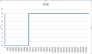

    In this case, the gauge is clearing the 4uV/s condition since the gauge is setting the [REST] bit. However, for the second relax, another bit to observe is the VOK bit, which depicts whether the OCV measurement taken during relax qualifies for the Qmax calculation. This bit is set during charge/discharge and cleared when the measurement qualifies. In this situation, it is not clearing for the second relax:
    This could be caused by the passed charge percentage idea talked about earlier since the disqualification conditions can be found below:
