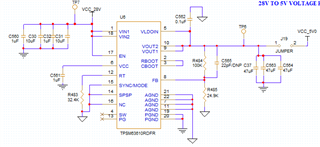

I have used TPSM63610RDFR buck converter.
Input: 28V
Output: 5V, 8A
Fsw: 500KHz
I have attached the design file. Please verify the design.
There is a design calculator for this device that can help you validate your design. Please fill this out and if you have any extra questions past the calculator parameters, feel free to reopen this thread and I would be happy to assist you.
