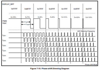

我们想选用LP8866-Q1的Phase-shift PWM Mode调光模式,该模式下,调光频率是不是由31PIN PWM_FSET脚的电阻值来选择?
输出电流调节占空比是不是默认由28PIN PWM输入的PWM占空比决定?此时对28PIN PWM输入的PWM频率有要求吗?
28PIN PWM输入的PWM频率与31PIN PWM_FSET脚选择的调光频率有没有什么联系?
谢谢!

In phase shift mode, the frequency is only related with the FSET resistor. Input frequency has no influence for PWM dimming frequency.
HI, Ansel
Pls refer to the datasheet spec. Analog dimming mode will change the duty into the current value.
Hi, Ansel
For PWM dimming mode, duty will change the output duty.
For Analog dimming mode, duty will change the output current. It depends on which mode you use.
If you want to change the current in PWM dimming, pls consider the current register.
