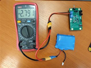

I'm using TPS2570 in my design with the same configuration like on EVM (BQ25798, TPS54531). I discovered there is high current when my device is turned off. I tried to write the same configuration in to the eeprom on EVM and checked the current there. And there is 2.78mA from the battery to the EVM when everything is turned off.
According to the datasheet, TPS should enter the sleep mode after time T of inactivity - which is few hundreds milliseconds. IPP5V,Sleep should be 2uA and IVIN_3V3,Sleep should be 56uA.
Why there is current 2.78mA from the battery on EVM?
Configuration:
-power sink and source
- max sourced 100W
- max consumed 100W
- preferred role power source
- no USB data
- no support BC1.2
- no vendor ID
- no product ID
- charger BQ25790 or 25792
- bat voltage 12.6V
- battery charging current 1A
- termination current and precharge 0.04A
Thank you.

    Here is my procedure: 1. connect battery to the EVM. 2. connect PD charger to the EVM. TPS negotiate charging parameter with charger, charging is in progress and everything works great. 3. Then I disconnect the USB-C from EVM and there is 2.7mA current OUT of the battery. After one hour there is still 2.7mA out of the battery.  Nothing else is connected to the EVM. Only battery and external 10k thermistor.
    Thank you
    Jozef

    I read registers when device was idle (as on picture I sent earlier).

  •   I don't understand. I sent only 2 attachments - the picture of connection and values of registers. Which one has a broken link?
     Thank you, I'll be waiting for your reply.
  • Picture of connections must be the broken link. I can see the register values you provided.
  • there is picture of connection

  • It seems there is no problem with the charger. Let's go back to TPS25750.
    I've made some measurements and here is the result.
    I measured the current in these two places and it seems there is a problem. Procedure is the same as I wrote earlier. 1. connect battery 2 . connect USB 3. disconnect USB and then I measure the current.
    According to the datasheet there should be 2uA on 5V and 56uA on 3v3.
    I have 2,3mA on 3v3 and 215uA on 5V
    It seems TPS is not in sleep mode.

  • I tried to read SLEEP_CONFIG Register with external MCU and SleepModeAllowed bit is asserted.
    So, device should enter sleep mode.
    MODE Register return APP - The PD Controller is fully functioning in the application firmware
  • Hi
    There have been no activity for 5 days. Can you help me with this problem?
    I've made a modification on EVM. I removed resistor R13 and I connected pin number 3 of U3 to GPIO0 on TPS with tiny wire.
    I also set plug_event on this GPIO.
    Now I have a battery consumption of around a few tens of microampers. But device can work only in sink mode. The source mode is not working. Before with the same eeprom content it was working.

    Jozef.
  • Hi Jozef,
    There was a hidden register preventing the device entering sleep mode. I have created a project binary with the settings you provided me that corrects this register setting. For our next Application Tool release, I will include this fix.
    Flashing the attached binary should allow you to enter sleep mode.

  • Hi Conner Gillette
    Thank you very much. Now your development board has consumption only 0.617mA.
    I've made measurements on 5V input 1uA and on 3v3 input 40uA. The rest of the current (550uA) is probably caused by BQ25798.
