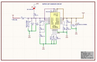

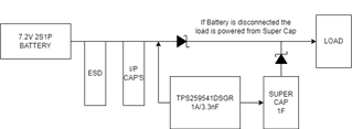

Hi
I would like your expertise part suggestion for the following application.
The main body with controller electronics are driven by a detachable power handle which has a 7.2V 2s1p battery pack along with fuel gauge and charger circuitry. The user has to change the existing handle with spare power handle when the battery runs out. During the power handle swap say 30seconds, I would like the super caps to take over from power handle batteries so the main controller stays On all the time.
Could you recommend the appropriate controller (hot swap controller? or Power Mux switch TPS2120?) which can be used for the above application.
Operating voltage 7.2v to 8V
Idle Current - <10mA (During swap the controller will be in idle mode)
maximum operating current 2A.
During the power handle swap, the hot swap controller must be powered on from the super caps as well.
let me know if you need more information regarding my application.
Kind Regards
DA
