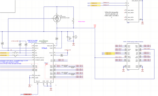

HD3SS3220: ID pin pulses low depending on what is attached to USB-C port
Part Number: HD3SS3220
ID is used to enable power onto the bus using a PFET.  The PFET is rated at 5.8A.
With nothing connected ID bit is high.
With only a mouse connected ID bit is low.
If more than the mouse, i.e. hub, keyboard, mouse is connected, ID pin pulses low for about 30us and then goes high again.
I get the pulsed behavior if only a USB thumb drive is inserted.
Any suggestions?
