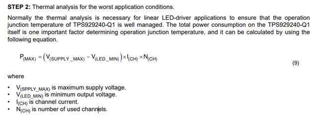

Hello:)
I was wondering if someone could help me to know the max power dissipated by the driver, I looked at datasheet but I didn't see this information.
Thanks in advance.
