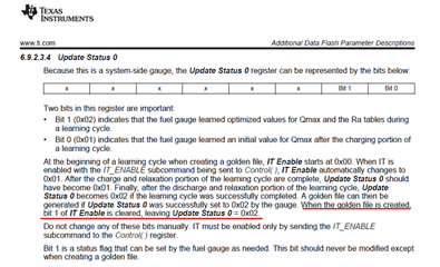

I think that I should extract the golden image with Gas Gauging:State:IT Enable = 00, and I actually want to do so.

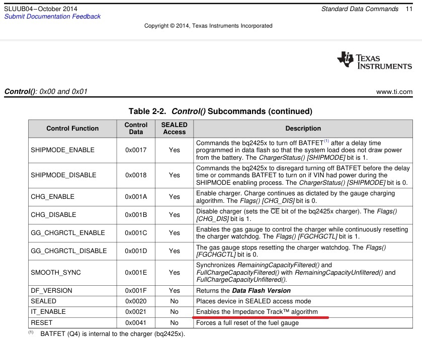

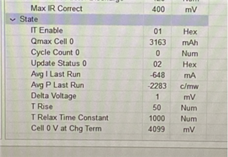

TRM SLUUB04 6.9.2.3.4 Update Status 0 states that IT Enable is cleared after the golden image is created, but this is not actually the case. After sending IT_ENBALE via Control() during the learning cycle process, IT Enable always remains 01 (even after extracting the golden image and going through several charge/discharge cycles).
Please provide the correct procedure to clear IT Enable to 00.
