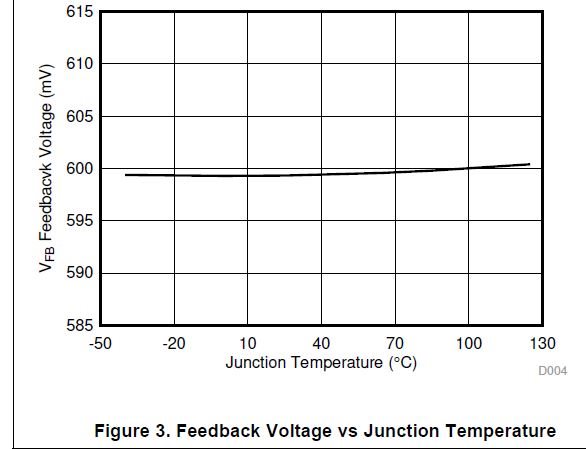

Our customer has a question about TPS566235 VREF accuracy in 0 to 85C Ta.
Would it be possible to help our customer the accuracy in this temperature range ? It may be OK in approximate number.
Hi Toshiro
1%-1.5% is the safe range even for 0-85C
Thank you
Savith
Hi Savith,
Would you provide the characterics data or plot ?
We expected the tolerance slightly becomre narrower while we checked below.
