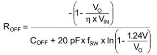

The design parameters and calculations are inculded in the led_driver.m file. The script was tested with the datasheet examples, it seemed to be working. (It is attached at the end of the post)

Coff = 470; %in pF
Vadj = 1.24; %in V
Vin = 24;
Vo = 22; %in V
Rsns = 0.08; %in Ohm
Iled = 1.3;
ilpp=0.085;
iledpp = 0.020;
rd = 2;
eta =0.95;
vinpp=0.500;
iled=1.3;
fsw = 515;
rdson = 0.012;
Vfd = 0.5;
Roff = -(1-Vo/(eta*Vin))/(490*1e-12*fsw*1e3*log(1-1.24/Vo))/1000
Roff=2.400
toff = -(Coff+20)*Roff*log(1-(1.24/Vo))
fsw = 1e6*(1-(Vo/(Vin*eta)))/toff
ton = 1/(fsw*1e3)-toff*1e-9
Cin_min=iled*ton*1e9/(1e3*vinpp)
L = Vo*toff/(1000*ilpp)
L=18
ilmax=iled+ilpp/2
Rsns=Vadj/(5*ilmax)
Rsns = 0.18
iled = Vadj/(5*Rsns) - ilpp/2
ilpp = Vo*toff/(1000*L)
Zc = 1e3*rd*iledpp/(ilpp-iledpp)
Co_min=1e6/(2*pi*fsw*Zc)
itrms = iled * sqrt(Vo/(Vin*eta)*(1+1/12*(ilpp/iled)^2))
Pt = itrms^2*rdson
id=(1-Vo/(eta*Vin))*iled
Pd=Vfd*id

  • Hello Balázs,
    I'm noticing more problems with your calculations. Starting with the first equation for Roff, I have copied and pasted your values and equations into excel and am not getting the same result as you. You also have the result listed as Roff = 2.400 instead of Roff = 2400, to be clear I can't get either result from your equation and values but in subsequent equations it appears you are using Roff = 2.400 instead of Roff = 2400 and not compensating with any multipliers.
    Along the same vein, in your equation for toff it appears you are plugging in 470 for Coff instead of 470e-12 to account for the units.
    I recommend starting your calculations over from scratch paying close attention to the units.
    Jaron
  • Hello Jaron,
    My calculations were based on the example of 9.2.2 in the datasheet. I had a deep look at the dimensions, everything seems fine for me. I applied the design vaules of the example design, and got the same results.
    Some values are hard coded, like the 470pF:
    Here fsw was designed as an input in kHz, therefore the 1e3 next to it. At the end it was devided by 1000 to get the resistance in kOhms. After that, every equation was in the same dimensions as in the datasheet's detailed design guide.
    So far I can see the same results as in the datasheet.
    Another question came to my mind. How does the driver circuit reacts to a lower voltage LED?
  • Hello Balázs,
    I've attached my spreadsheet. It appears that you recorded the incorrect result for Roff but used the correct result in all subsequent calculations. I am getting Roff = 5.51 kOhm not 2.4 kOhm and when 5.51 is used in the subsequent equations you get the correct results. Please review.
    The device regulates current, not voltage. It adjusts the output voltage to whatever is needed to supply the set current through the LED. If the LED has a lower forward voltage, the circuit will reduce the output voltage accordingly while keeping the current constant.
    Jaron
    LM3409 calculations for Balázs.xlsx
  • Hello Jaron,
    Thank you for your worksheet. I found a difference in the calculations. It seems like excel's LOG function is on base 10, if not specified differently, however octave's log is equivalent to ln, which was given in the datasheet.
    After adding the e base into excel, I get the same results as in octave.
