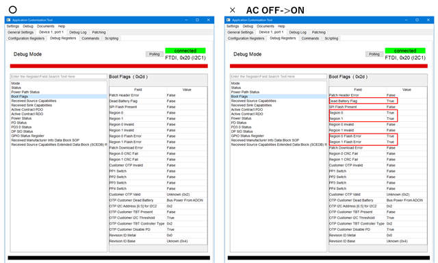

I am currently conducting experiments using the USB-C-PD-DUO-EVM.
The connections are as follows:
iPad - EVM < - AC adapter (20V)
What I want to do is to power the iPad using the EVM as a source.
When I connect the EVM to the iPad with a cable while the AC adapter is connected, power supply to the iPad begins without any problems.
In this state, I disconnect the AC adapter.
Then, I reconnect the AC adapter.
At this time, power is not supplied to the iPad.
In this state, if I unplug the cable and reinsert it, power supply will resume.
I am attaching the current settings file.
Could you please point out the configuration error that would solve this problem?
