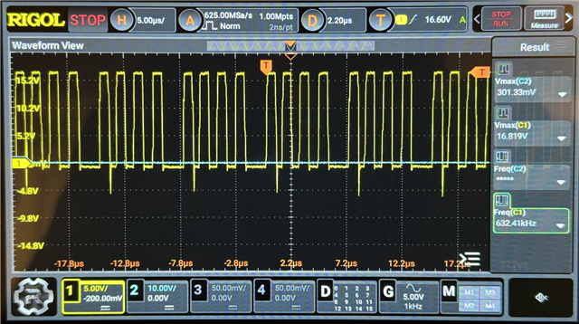

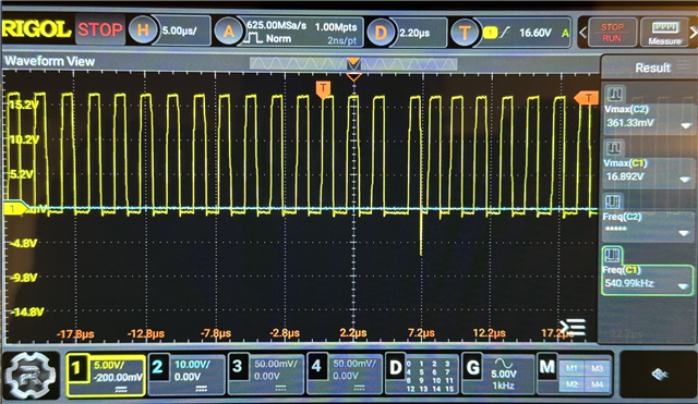

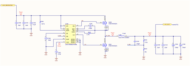

I designed a 5V buck based on the LM3150 to support a 4A load.
On the LM3150 EVM I have, the switching frequency of the high gate is stable under load or no load. On my own design (wide input 5V buck), the frequency seems to skip a pulse when there is no load:
When there is any load applied, the switching frequency seems to have a lot of jitter, and also skips pulses:
Here's a screenshot of my design. Note that I made a mistake tying the EN to the input voltage, so I just cut the pin on the IC to prevent it from being connected, it is floating.
