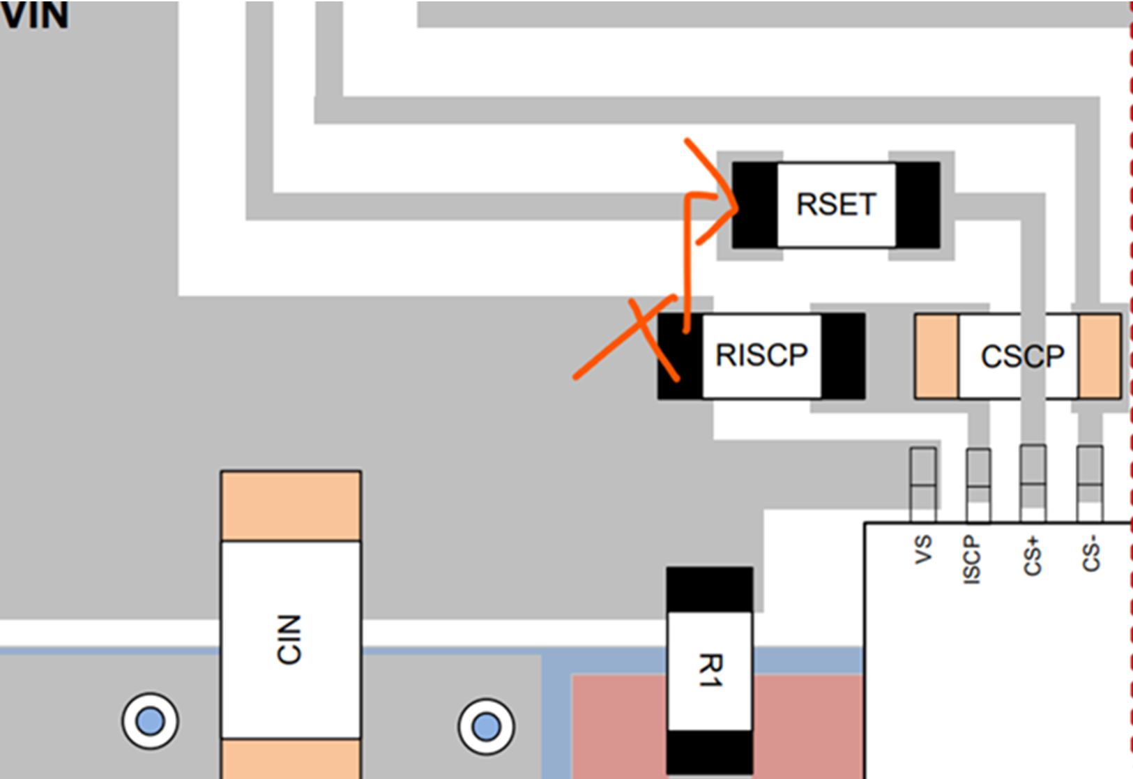

  5. The range of I(iscp) is 13.7uA-17.6uA. In our current application scenario, the error of the short-circuit protection point is ±30A. Is there any way to reduce the fluctuation of I(iscp) and improve the protection accuracy?

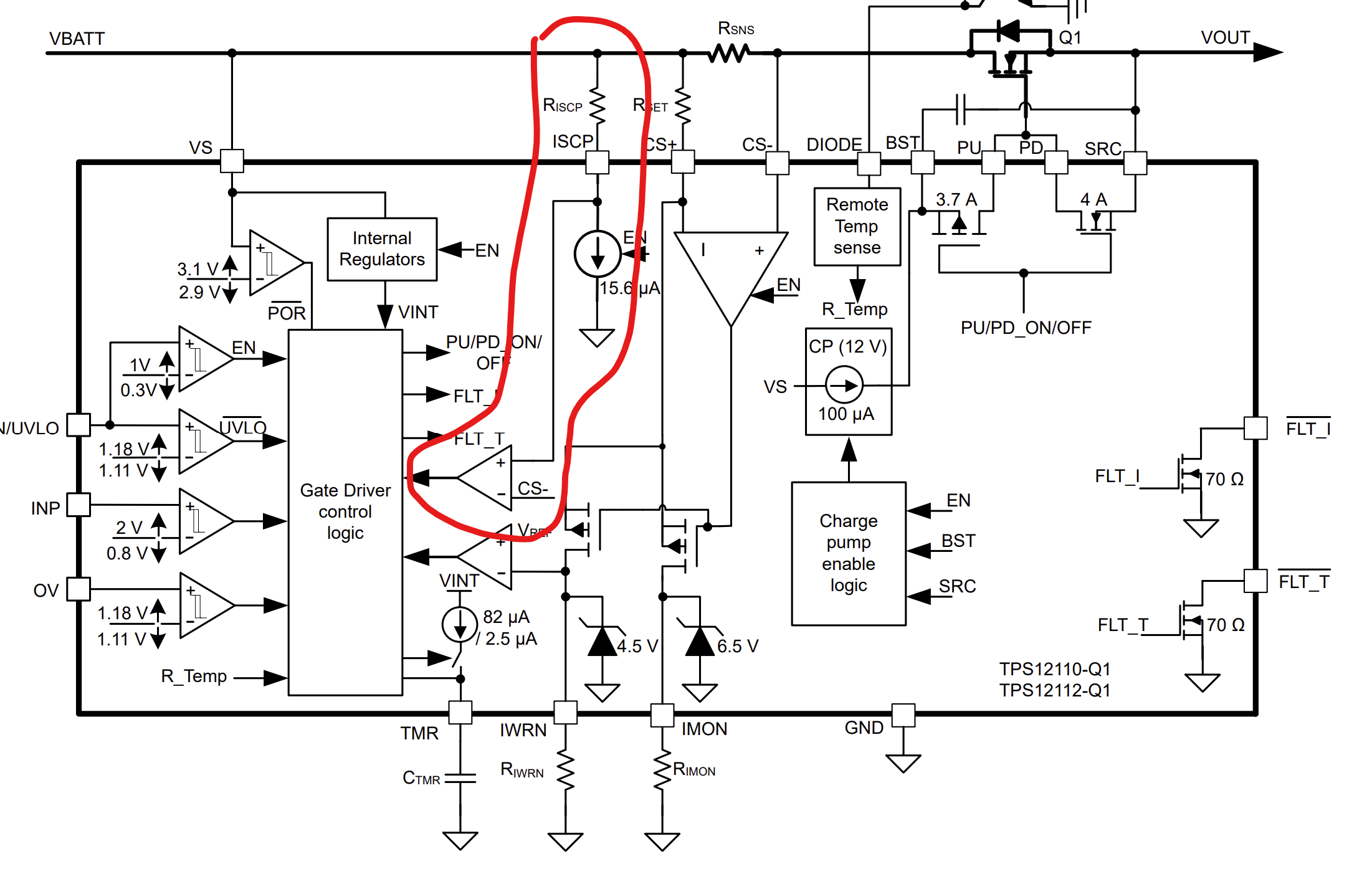

    For #5, the layout placement of the SCP resistor will help with accuracy here. The SCP setting is operated by an internal comparator that looks at the reference after the SCP line and the CS- line as seen below:
    This means that if there is a lot of impedance between RISCP resistor and the RSET resistor, you will run into a lower current limit trigger at higher current settings. The solution here would be to minimize the trace impedance as seen below:
    This should help with improving the SCP accuracy.
