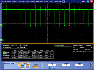

Hi to all,
i did a new design with LM5012 which works mostly fine. The only issue is, that the circuits switch to an intermittent operation after a while (see oszi picture below, 10:1 divider) at a input voltage of 19,2...19,5V. This happens after 15min operation, so i think it's an temperature issue? When cold, most circuits are working correctly even at 17,5V input voltage. The "warm" circuits are operating correctly at a voltage of 22V, which ist too high.
Data:
Uin: 19,2V to 57,6V
Uout: 18V
Iin: 500mA at 24V Uin
Switching frequency: 200KHz
Looking forward for some helping hints - thanks in advance

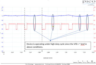

    please see attached the ripple waveform, measured at PIN5 of LM5012. C11 is populated with 100p.
    PODIS_FAIL_02_24V.pdf
  • Hi Nobert,
    Thanks for the FB voltage waveform along with SW node. Based on the waveform, the device is operating in high duty cycle due to incorrect ripple at the FB pin. Can you double check the ripple generation components or can you increase the ripple voltage to say >30mV by varying RA, CB, CA values.

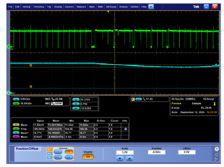

  • Hi Nitya,
    sorry, but i have to come back to this once more.
    By replacing the output capacitor with a 22uF tantalum, i could use 7 of 10 boards without failure.
    3 boards showing this signal (below) at 19.2V input voltage (measured at input capacitor).
    RA: 137K, CA: 3n3, CB: 47p
    Moving CB to 100p without change in waveform.
    Can you explain me, in what mode the IC is there and what to do, to get it as the other boards?
    20240917-0001.pdf
    Kind regards
    Norbert
  • Hi Nobert,
    I would check the feedback voltage along with switch node in both fail and pass devices to check if the feedback voltage is as expected. If the injected signal is as expected, then it is LM5012 issue else we need to check injected ripple components derating values.
    Nitya
