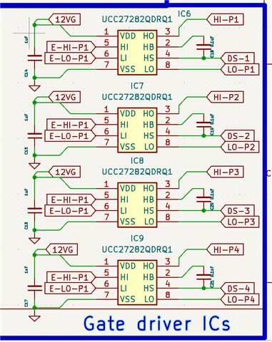

-In both designs, E-HI-P1 and E-LI-P1 are controlled by an ESP32 digital pin. E-HI-P1 controls all the "HIGH" side driver inputs "HI", and E-LI-P1 controls all the "LOW" side driver inputs "LI".
-GND is battery negative. P1/2/P2S-E/... mean battery positive 1/positive 2. (Both designs are for a 2S battery balancer)
-Also all drivers have been driven by an ESP32 or Arduino UNO

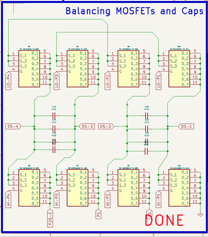

Here's the schematic of the first design:
Here each driver controls 1 pair of mosfets, therefore 4 drivers. It made more sense because that way I could connect DS-1 to line GND, DS2 to line P1, DS3 to line P1 and DS4 to line P2.
Results with this design:
- 1 X board seemed to have succesfully balanced out a approx 1V difference between 2 batteries in like 24 hours. (small switching frequency), cool

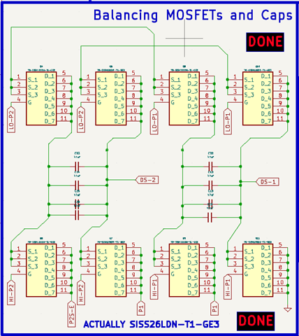

Here's the schematic of the second design:
Here I used HO and LO each driving 2 mosfets so 4 in total, 1 driver per 4 mosfets. But which is which? Which is HIGH side and which is LOW side? I also didn't know where to place DS so I just placed it on the GND line (when the capacitors are placed in parallel)
Results:
- 1 X board today, nothing on fire, but didn't seem to balance even 1mV in 15 min, switching frequency 500Hz, 1V difference between batteries

    I just want to know if the way I am connecting the drivers to the mosfet gates is right. 1 Gate driver/ 4 mosfets  (2 HIGH side, 2 LOW side).
    Right now 1 driver drives mosfets M1,2,5,6 and one driver drives M3,4,7,8 as in the image. The mosfets at the bottom of the image are considered HIGH side, while those at the top are LOW side. Come to think of it, the voltage required to drive M2 might be different than that required to drive M1. Because the voltage difference between Drain and Source (Vds) for M1 is GND -  (Whatever charge the caps have), which is negative, while M2 has (Voltage of the First battery) -  (Whatever charge the caps have on the other side)

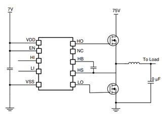

    The gate resistors are in place between HO/LO and the gate of the MOSFET, so it is in series with the HO/LO path. This is for controlling rise and fall times and preventing overshoot. The guides above have some insight on sizing that gate resistor.
    It is acceptable to connect 1 output (HO/LO) to multiple parallel FETs so you can drive 4 total FETs with the UCC27282-Q1. When connecting the gate driver to FETs, you need to ensure that you are in a typical half-bridge configuration so that the bootstrapping circuitry can operate as discussed in the App Note that I linked in my reply above. Overall, your configuration should look like the following with the exception of the inductor in your case:
    If you do not have a setup similar to this, you will need to make provisions for biasing the high-side instead of bootstrapping.
