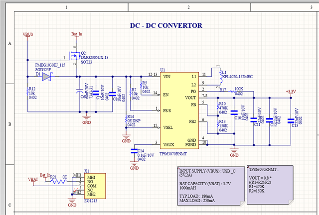

I am reaching out to request your expertise in reviewing the schematic design TPS63070RNMT .
Your insights would be invaluable in ensuring that we address all potential issues and refine the design to meet our objectives effectively.
Attached to this email, you will find the current version of the schematic design. Specifically, I would appreciate your feedback on the following aspects:
  • Functionality: Does the design effectively support the intended training goals?
  • Usability: Are there any improvements we can make to enhance user experience?
  • Feasibility: Are there any technical or practical concerns that we should address?
  • Hi  Nithi,
    Would like say schematic is well designed, no concern from my side. But it is better if you can reserve a 0402 package in parallel with R10 for feedforward cap.
    Also, in case R14 mounted, it is better to have a resister serial between VSEL and GND.
    One question is why you choose TPS63070 for your application? seems a device only support 5.5V vin max is enough for your case, right?
    Tao
  • Hai Zhang ,
    Thanks for your feedback .
    Our application was battery operated one and Vbus = 5V (from USB C)
    I would like review my PCB file from your end. how can I reach you?
  • Hi  Nithi,
    I just send a relationship request to you, please accept and then you can send me a privite message includ your design file.
    Tao
