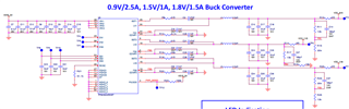

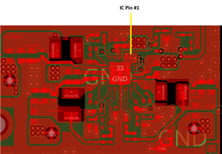

Hello ,
 We have used  TPS65266RHBT multi-switcher IC to meet specific parameters for our project. Here are the requirements:
Input Voltage: 5V
Output1: 0.9V @ 3A
Output2: 1.5V @ 1.5A
Output3: 1.8V @ 1.5A
for which after Load testing results
1)  For 0.9 V at low load
Vin(V) 5
Iin (A) 0.15
Vout(V) 0.79
Iout(A) 0.502
Total Load(ohm) 1.574
Input power(watt) 0.750
Output power(watt) 0.397
Efficiency(%) 52.87733333
For 1.5V at low load
Vin(V) 5
Iin (A) 0.14
Vout(V) 1.48
Iout(A) 0.302
Total Load(ohm) 4.901
Input power(watt) 0.700
Output power(watt) 0.447
Efficiency(%) 63.85142857
we have observe very low efficiency that doesn't meet our requirement as we want  more than 90% efficiency
We have also confirmed the design before fabrication in these Thread: https://e2e.ti.com/support/power-management-group/power-management/f/power-management-forum/1350417/tps65266-tps65266rhbt/5166714#5166714
I'm attaching the snapshot of schematic and layout please suggest us required changes to meet our expectations.
