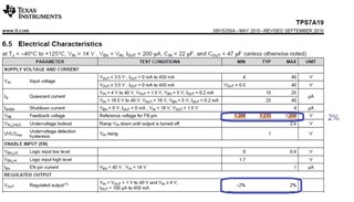

In the d/s, it says that output voltage regulation is +/-2% over temp. Is it including line regulation and load regulation? Thanks!

One more question.
The Vout regulated output range +/-2%. Is the deviation of feedback deviation +/-2% already taken into account in the VOUT regulated range?
Hi Brian,
The feedback divider resistance tolerance is not included in the spec, so the ±2% spec for VOUT is the same as the same as the spec for VFB.
Nick
Thanks Nick. Two more questions here.
1. You mean that the +/-2% variation for VOUT that is only including VFB variation, right?
2. In the E/C table, the VOUT variation is not considering the external Feedback resistors of R1/R2. If customer would like to get more precise calculation at worse condition, the R1/R2 variation needs to be taken into account?
Brian
Hi Brian,
Yes that's correct. The feedback resistor tolerance needs to be considered as well, and the 2% spec does not include it.
