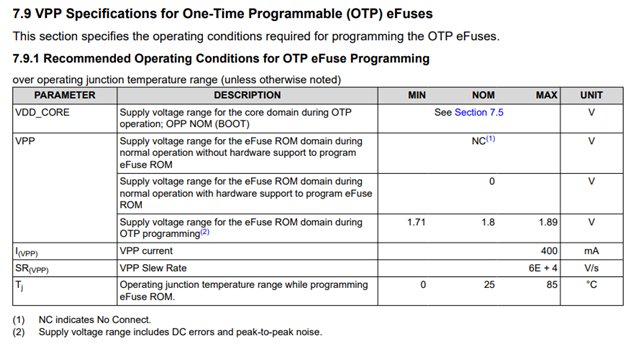

This is Skylar responsible for GREE. They want to use TPS7A26 to lower down the voltage from 3.3V to 1.8V.
Could you pls help tell me the load transient response of TPS7A26 and if it could satisfy the requirements as below? What about TLV75518, TPS7A21 and TLV70018? Thanks!

    My reading of this datasheet is that the slew rate is not a load transient requirement, but rather it is a maximum slew rate for turn on of the LDO output.  A maximum rate of rise is a common spec that we sometimes see for our power supplies.
    I.E. the slew rate of the LDO output turn on time must not exceed 6E+4 V/s.  Please confirm and I can review the LDO's you have asked about and get back to you.

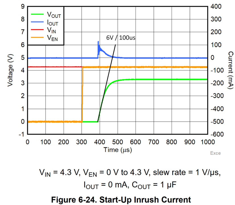

    TLV700 and TLV755P will meet the requirement.  The TPS7A21 is marginal but due to the exponential rise, it likely does not meet the requirement during the initial turn on.  The TPS7A26 turns on too quickly and will not meet the rate of rise requirement.
    In my response I am using the fact that 6e+4 V/s, 60 V/ms and 6V/100us are all the same thing.

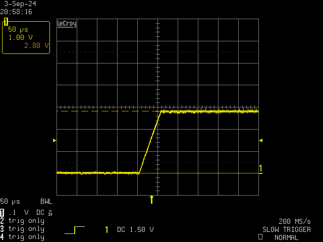

    TLV700
    I could not locate a turn on waveform for the TLV700 so I measured the TLV70028 (2.8V option) on an EVM. It turns on slower than the 6V / 100us spec.

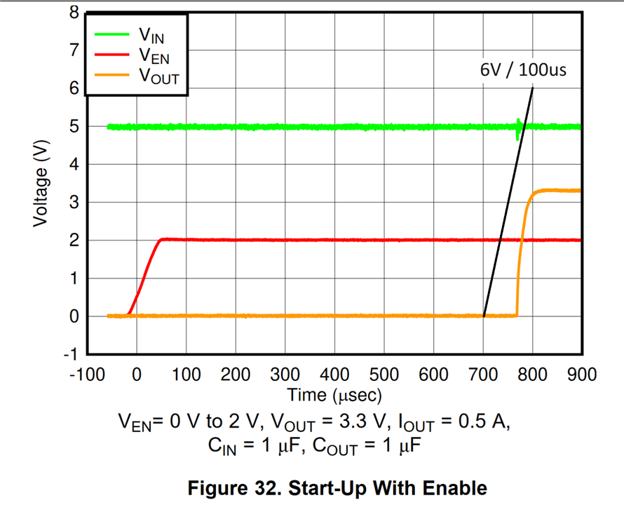

    TPS7A26
    The TPS7A26 cannot meet this requirement.  It rises faster than 6V / 100us.

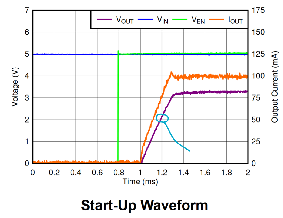

    TLV755P
    The TLV755P can meet this requirement. During the fast charge portion of the turn on time (linear ramp) it rises in 2V/0.2ms = 10 V/ms.

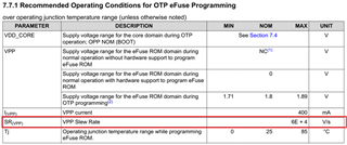

  • Hi Stephen,
    Thanks for your reply. Add information as below. The Vout of LDO needs to satisfy the VPP requirement of AM62x as below.
