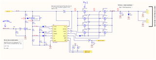

TPS2492: TPS2492 Back to Back FET failing
Part Number: TPS2492
I am trying to use the TPS2492 with a back to back FET design. I am using the UVEN to turn off the FETs in an E-Stop condition. I am having the first FET on the battery side failing short when the Enable signal is pulled low under power (~5A load).
I have tried adding TVS protection and a capacitor similar to the output but that didn't work.
Do you have any suggestions on what the cause of the problem could be? I can take measurements of different things if that helps as well.
