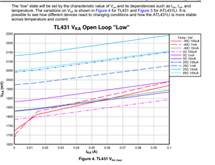

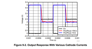

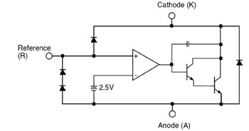

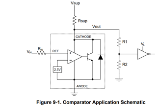

Customer would like to implement the comparator by TL431.
question 1: What's the voltage stress of the REF pin?

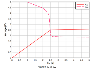

2. When VIN > 2.5V, the VKA  is conducting about 2V. I don't the see the datasheet E/C table has addressed the "2V". thanks.
