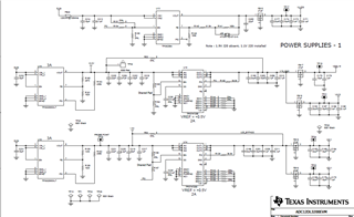

  • Hi Andreas,
    Thanks for the quick response.
    Yes we are using second stage LDO from 2.2V to 1.9V and 1.5V to 1.1V in the design.
    In ADC reference design as shown below, For U18 and U19 they are using 3A rated IC, but instead of that can we use 2A IC??
    Haitha
  • Hello Haitha,
    thanks for your feedback.
    I think the 2A version TPSM828302 would be sufficient.
    Andreas.
